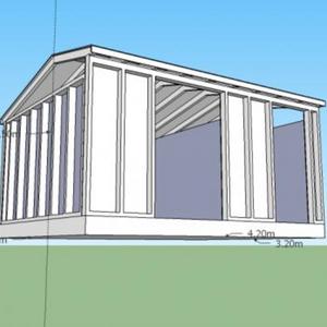

    Shed design - advice on rafters
    I don't have the space for this, it would push the overall height over 2.5m or reduce the internal height by 2 inches which is already at the limit of what I can manage
    OK so what is the normal way of ensuring air flow above insulation if using a ridge beam? Also, would it need to be bigger than 2x4, would 2x6 be sufficient in this case?
    OK but I have seen various designs around which do not have either, for example the first picture here: http://www.shedking.net/How_to_build_a_shed_roof.html How do you calculate whether or not extra support is required?
    I am currently designing a combined garden office / storage shed. Due to the location within 1m of a boundary, I'm limited to 2.5m total height, as well as max 15m^2 area. I'd like to get as close to these limits as possible. I have put some initial designs together using Sketchup...
