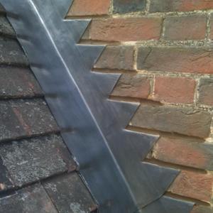

    lead flashing
    They are slates. Ideally i want the "drape" to match the horizontal flashing at the top of the bay window. Basically in that pic, if they were slates, would you use soakers? cheers
  8. J
    lead flashing
    Hi, Im putting a flashing like this on a slate foof, purely so it matches in with the apron/flashing at the top of an abutment bay window. Do i need to put soakers in under it all. Im sure you dont but ive begun questioning myself cheers
