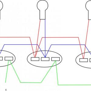

    Thanks for this. It sounds as though I need to get a multimeter and test. I had a look to see if there was an obvious mistake, but couldn't find anything wrong.

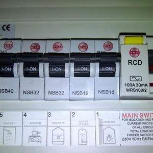

    It's the RCD switch (with test button), as you guessed. This is running off of a mains socket, via an extension lead, to the first connector, which is a ceiling rose. How would you recommend I test it before powering it up again? I took a picture of the consumer unit. The switch that...

    Hello. I want to make a light fitting with three bulbs that plugs into the mains. I've attached a circuit diagram of what I had in mind. I put it together, plugged in the last bulb on the circuit only (i.e. the one on the far right of the diagram), but when I turned on the power it tripped...
