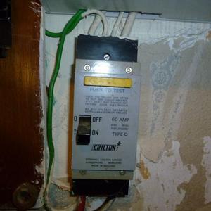

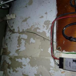

    Earth to Consumer Unit
    So I got it sorted. The door fitters were stars and indeed we did manage to cut a conduit outside the new door frame for the "earth" cable to pass through. Temporarily. Thankfully I am now aware that my electricity system needs updating - to be fair I would never have known or bothered...
    B*gger. B*gger. B*gger!!! Defeated. This is getting way beyond my level of having a go. At least I am still alive so many thanks again for all the knowledge and sound advice. Have decided to postpone the door fitting for tomorrow (the fitters will be pleased!), take the safe...

  4. J
    Yes the electricity comes from a pole. Pic of Chilton box below: Thanks
  5. Untitled

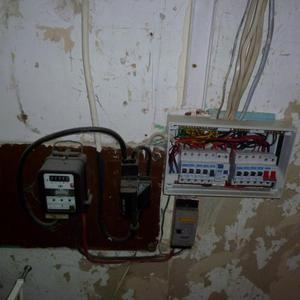

  8. J
    Hi & thanks for the quick reply. 3 photos attached (hopefully). Does this provide what is needed? The cable with the red hand-drawn "circle" is the one that goes out of the house through the door frame........... Cheers http://media.diynot.com/174000_173871_37799_70039311_thumb.jpg...

  12. Consumer Unit pictures
    Pictures
  13. J
    [come in Consumer Unit :lol: ] Hi All, Would be grateful for any help please. There is a switch between my meter and consumer unit. This is earthed locally. The consumer unit is also earthed (if everything is sound - the cable looks to have been there for 20+ years). The...
