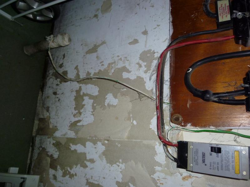

There is a switch between my meter and consumer unit. This is earthed locally.
The consumer unit is also earthed (if everything is sound - the cable looks to have been there for 20+ years). The cable run is about 4 metres before it is connected to an earth point outside the house.
Unfortunately this cable passes through the wooden door frame of my front door. I am having a new door installed and need to move this earth cable. I do not want to drill through the new PVC frame to replace the existing connection.

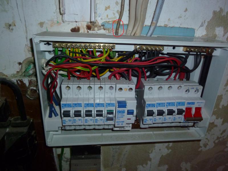

The pics suggest an old TT system which is protected by a voltage operated earth leakage circuit breaker.
These are no longer recognised by the regs as parallel paths can cause them to be uneffective.
Your consumer unit is a split load with an RCD covering half, the other half is only protected by the VOELCB.

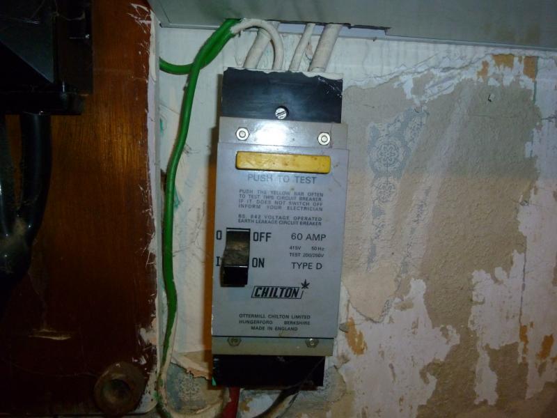

It sounds like you have a TT system which has an external earth rod. Can you get a clearer picture of the white box with Chilton written on it?
It looks like an old RCD think it best to get an electrician in before the work on the door is carried out

That is a VOELCB as I said above ;)
You need an electrician to have a look at the system, the old earthing should have been connected through the VOELCB, i.e. earth spike to one terminal on VOELCB, CU to other terminal on VOELCB.
These devices are no longer recognised by the regs and havent been for some time.
The more modern RCD does not have an earth connection. I wouldn't be suprised if an electrician tells you that you need a new consumer unit.

You cannot get rid of the earth conductor going to the earth rod outside, and you cannot get rid of the bonding conductor going to that (gas?) pipe.
It appears to me that your current earthing is the small cable from the VOELCB to the earth rod, there also appears to be a cable from the VOELCB to the consumer unit earth rail.
The other cable you see out of the top of the CU could a main protective eq. bonding conductor to water pipes etc (which can render the VOELCB useless by creating parallel paths for fault current to flow which is why I said you need a sparky asap.)
I wouldn't touch the earthing for the moment, as I said above the VOELCB relies on the earth spike being connected to a separate terminal to the earth from the consumer unit, wether or not it is still servicable is another matter.
