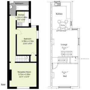

  3. Proposed first floor plan
  4. Project A
    Project A
    One bed maisonette convert to 2 bed maisonette with loft conversion.
