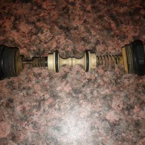

    Heatline C24 possible pump problem?
    Hi folks, I'll try to give quite a bit of detail to aid clarity... I have a C24 which, after about 3 years of use, gave out when the diverter valve failed due to a water leak. This shorted the diverter motor. I believe this is a common fault. The plan was thus: Buy service kit/new motor...
