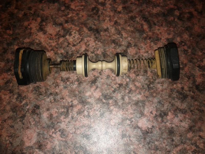

My first stop is to question the diverter service kit, I used some spares to demonstrate how I put it in, can anyone confirm this is the correct order so I can immediately rule that problem out?
