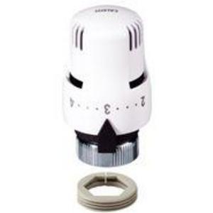

    just thought I'd update you, the head in the conservatory was unfortunately a different connection, bought a new one for the bargain price of a fiver and now have a fully functional radiator..... who needs to pay out for an expensive plumber :D Thanks everyone for their help

    yes the thermostat head. I'll leave it off while it's cold..... I do have a rad in a conservatory which I leave on full, will try changing them over & see if that works Thanks for all you're help..... :D

    I've added an image of the thermostat control head....not sure if it will show, it maybe clear I'm new to all this ! there is another connection the other end, which I'm guessing is the lockshield you mentioned? I've left the cap off for now & radiator is red hot ...... [/img]

    yes its a TRV.... I think :lol: I've unscrewed it and removed the plastic cap & the radiator instantly heats, but within about half an hour of replacing it it goes cold again. Not sure if it helps but it's a Caleffi.
