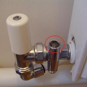

    Leaking radiator valve
    OK thanks for the advice. I will dismantle it tomorrow and try to get a replacement nipple. Cheers.
    so i need to tighten that square bar? Because i tried and it just spins round and spurts water out?
  9. K
    hi where is the brass nipple located?
    Hello, i have a leak coming from the valve on a radiator. Below is a picture with the source of the leak circled. Please could someone tell me how to fix it? Thanks.
