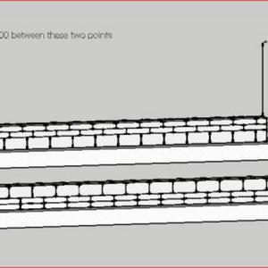

    New extension footing off square by 50-60mm
    Yes indeed very poor. Looks like it may have gone off on 1 wall I'll get it rebuilt better to sort it now than deal with the knock on effect Thanks for your helpful reply.
    Hi, Thanks for the reply I have uploaded image on link below. https://dl.dropboxusercontent.com/u/187743/foundation.JPG [/url]
    Is it is easy to recover 50-60mm? Solid block footing 320mm wide just went in on new house extension and parallel walls are off square by 50-60mm Foundation is 900mm wide -footing are solid block (215x440x100mm) next part of build is cavity wall on top of footings = 2 x 100mm blocks...
