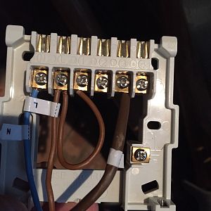

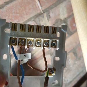

    So here is the way you described just to double check is this right? IMG-20161228-WA0002 by Lee42534 posted 28 Dec 2016 at 3:11 PM

    Thanks for the quick reply its ruddy freezing tonight and its located in the garage. I will report back tomorrow with a pic of the correct wiring for you to kindly double check. Thank you

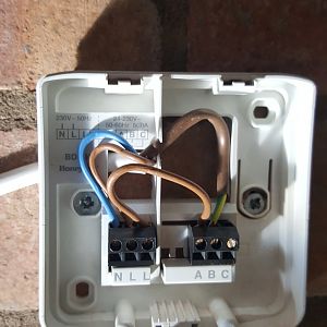

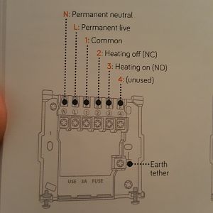

    Just wondering how to replace a honeywell bdr91 with a hive 2 receiver The boiler i have is a viessmann vitodens 100 Heres my current honeywell wiring 20161227_121343 by Lee42534 posted 27 Dec 2016 at 4:31 PM Does anyone know what wires go where on the hive receiver from what ive found out...
