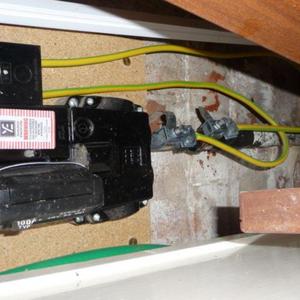

    Just two heavy duty wires from breaker box to the meter as depicted 2 posts above. (wire on the left of these two just goes to bell transformer) You can see two green/yellow going upwards from the breaker box; one goes to the gas pipe, and one up into the garage ceiling.

    Here's the circuit breaker: Is that what you want? The two righthand large cables at the bottom go to the meter (see earlier picture)

    thanks for this. I'll stop worrying :-) PS Here's a closeup of the two clamps:

    ... hmm... actually it may be TNCS, but unlabelled (no safety sticker on the gas bond either). See: though I was expecting the earth to neutral connection to be done at fusebox, not the other side of the meter.

    Thanks for this. No sticker on the main circuit breaker box, so presumably not TNCS; Of the green/yellow wires leaving the breaker box, one goes to the gas pipe, the other goes up to the garage ceiling, and then I know not where! In any case, back to the original topic of the post, it sounds...
