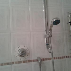

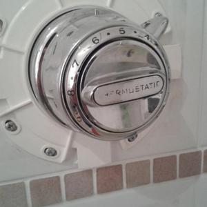

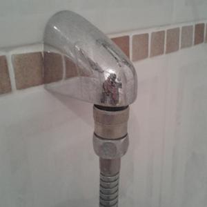

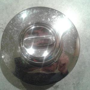

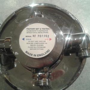

    Shower Identification Help
    Shower still dripping dispite new seals, and only just got around to looking at it again! (can isolate fairly easily, so been doing that!). Now I've also found a correct section view of the shower unit, I can see which o-ring is tha main seal - I've looked at the seat where this o-ring seals...
  4. L
    Thanks for that - I've ordered a new seal kit, so hopefully that will sort it! Your a *
  5. L
    Brilliant! So at about £130 for a cartridge, is it worth replacing totally? The 'leak' is that it drips really badly when turned off. I've checked the main o-rings on the cartridge and they look basically OK (although I haven't replaced them). For a dripping unit, is it likely to be the...
  6. L
    Nice one - looks like that could be it. Uploaded another image showing the coverplate. I'll google some more info on that model and see if I can confirm your excellent response!
  7. L
    Here's one to test your knowledge! I have a leaking thermostatic shower which, if I knew what make it was, I could look at getting a new cartridge for. However, there are no markings on it at all indicating the make, let alone the model. Does anyone recognise what it might be from these...
