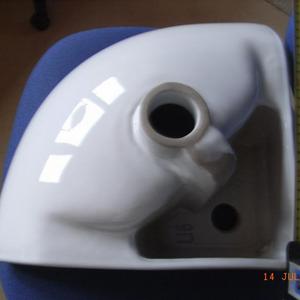

  2. L
    Fitting a wash basin
    Thanks both for replies. Dextrous - I agree we know it should be stable - but it isn't. Seco - the problem is that the brackets aren't in the corners. The shape under the basin is such that the brackets can't come further than half way forward. The side of the basin is 370mm. The furthest...

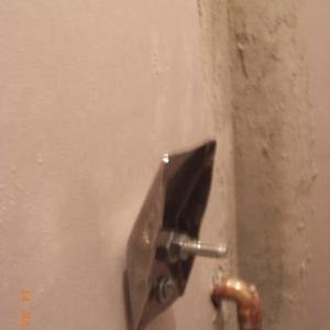

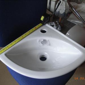

  4. L
    we have bought a small corner wash basin. It comes with support brackets that the basin 'sits on. However when we put the basin on, it tips forward because the weight is further forward than you can get the brackets. We have wondered about using one of the bottle traps that has a bracket to the...
