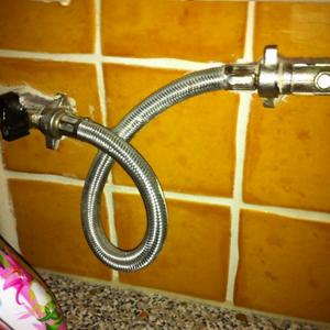

  3. L
    Combi boiler, 3 radiators not getting hot
    Ive been turning that black valve to top the boiler up when the pressure has been getting too low... so yes, it is turned off but its still connected to the mains supply... If I take it off water will go everywhere...
  4. L
    The valve on the rad at the back of the front room is VERY stiff... There is another radiator in another downstairs room that has the same valve... When we first moved in I was turning this rad on/off to regulate heat and the carpet was getting wet around the valve... it doesnt appear to have...
  5. L
    This is not supposed to be permenantly connected? right? Can I remove it somehow without water spurting everywhere?
  6. L
    If I do this and they do heat up, what does it tell me?

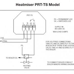

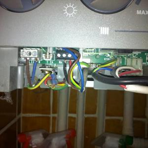

  8. L
    Honeywell T63660B 102B upgrade to Heatmiser PRT Wifi
    I was going to ask about the lack of neutral, just checked at the boiler end and Neutral isn't connected there... so the earth really is an earth. (Ns terminal not connected) I can run more cable without too much hassle, also not a problem to flush mount a box either... I think I have...

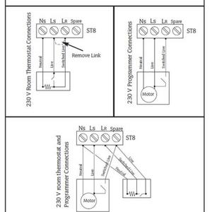

  9. L
    Chaps, finally managed to find the manual for the Heatmiser PRT... As far as I can tell the 3 wires I have are enough? The heatmiser has "volt free contacts", which is just a fancy way of saying that it has a relay in it... Running a wire link from L to A2 like in the diagram and then...
  10. L
    Yes, the heatmiser wifi looks to be the dogs dangly bits. According to the boiler wiring diagram, I have Live, Neutral and Switched live... The neutral is wired into the earth socket on the Honeywell.

  15. L
    I'm looking to upgrade a Honeywell thermostat with a fancy wifi one... I must say that I'm a little baffled by the wiring on the Honeywell as there only appears to be 2 wires as well as earth... the Heatmiser PRT wifi's state that they need 3 wires as well as earth... I've included...
