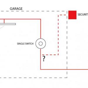

    HOW TO ADD A PIR SECURITY LIGHT TO EXISTING GARAGE LIGHTING.
    Added a picture to my albulm, not sure how to add it to post please visit my albulm, existing wiring in red, security light new wiring in red dashed line. Question mark is where I need to connect. Thanks
    The supply comes form the house on with its own circuit breaker MCB B6 TYPE. It has an old round switch with 2x 5 foot (aprox) standard tube light units. Dont know the load? I am fairly handy around the home but wanted some expert advise on this as getting in a sparks to do this simple...
    Thanks for that, just one question. Do I fit the double pole switch between the feed in and existing garage light switch, and run the security light from the double pole switch? Thus leaving power to the security light all the time whilst still being able to turn the garage lights on and off...
    Hi all I would like to install a security light to our garage, and would like some help on the matter. In the garage we have a feed coming in from the house, this has its own fuse in the main box under 'GARAGE' which is an MCB B6 TYPE. The only lighting in the garage is the feed coming...
