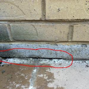

    Does that mean the garden paving on my neighbour's side is too high? I'm sorry I'm getting lost in translation. That paving was only laid last year but I didn't have any damp problems before so your suggestion seems very reasonable. Thank you.

    Thanks again, ree. The holes under the concrete slab can't be inspected further as it's a solid floor with terracotta tiles in the extension. I guess I just need to get the exterior area around it dry and get the holes filled. I'm a bit rubbish at the terminology - what's a high yard corner...

    Ree, thanks so much for your help with this. I've added a few more photos to try and give some better context. The extension is a solid concrete floor with terracotta tiles. There is no damp to be seen in there but there is in the dining room which is the nearest room in the main section of...
  5. Holes under grey slab at base of extension
    These are the holes I've found under the extension. It's near the corner where it attaches to the main building. The other side of this wall is a solid concrete floor covered with terracotta tiles. There isn't damp in the extension but there is in the dining room (nearest room in the main house).

    Thanks ree. I think a kickout is just what's needed. The photos are taken from my neighbour's garden. The house on the left and the pipes coming down are my neighbours and the yellow brickwork is my extension (done about 8 years ago). The channel around her house is from the boiler outlet...

    I have a single storey extension and the downpipe from the roof brings the rainwater to guttering along the edge of the extension. There is a small amount of water getting between the end of the guttering and the flashing on the house wall. These drips have caused a damp patch to seep into my...

    Closer view of the damp corner, behind the soilstack pipe. And the holes under that grey slab, on the side of my extension, can be seen clearly.
