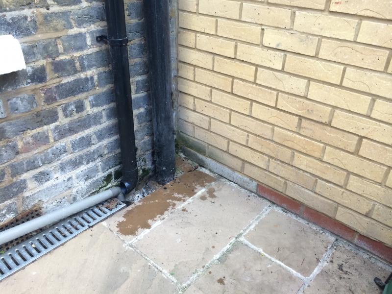

I have a single storey extension and the downpipe from the roof brings the rainwater to guttering along the edge of the extension. There is a small amount of water getting between the end of the guttering and the flashing on the house wall. These drips have caused a damp patch to seep into my house. (The drips are landing on my neighbour's side of the wall, next to her drain, but due to holes in the mortar at floor level on my extension it's got into my dining room.)

The shoe on the RWP is directing its discharge towards the wall ie. the green staining stuff, and the channel has stopped short of the extension.
Digging around the soil pipe and filling with gravel might help - a French drain effect.
Where does the channel drain to, and where's the outlet?

The photos are taken from my neighbour's garden. The house on the left and the pipes coming down are my neighbours and the yellow brickwork is my extension (done about 8 years ago).
The channel around her house is from the boiler outlet (the other side of her garden back door) and leads to the drain near the corner (sees in the photo). The drain was completely blocked and I dealt with that a couple of weeks ago so was hoping to see improvement to the damp in the house but it hasn't reduced.

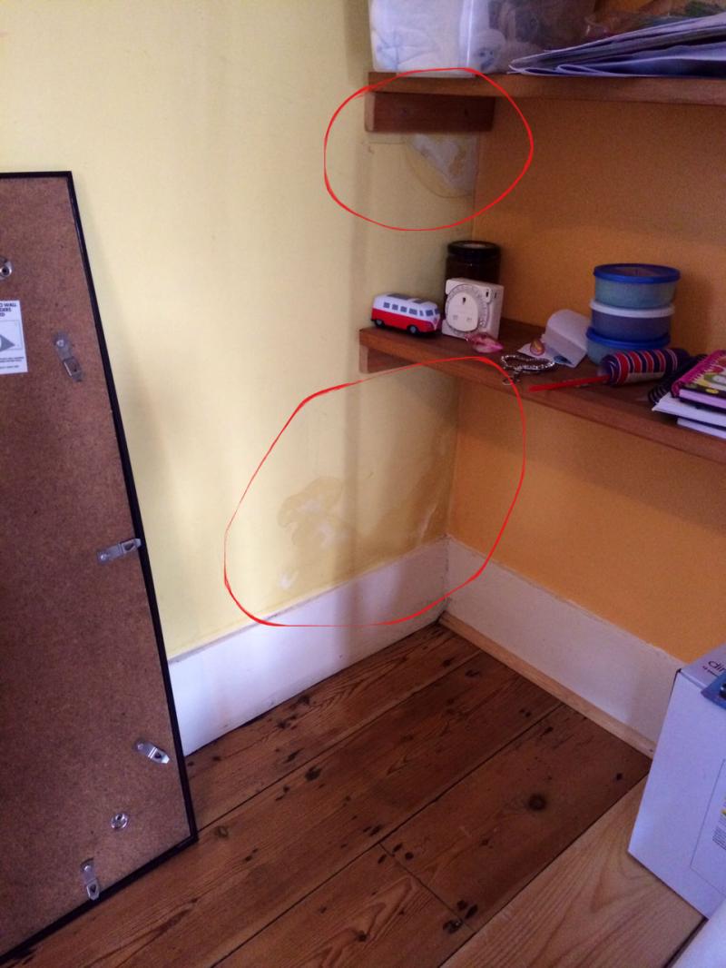

I've added a photos of the damp in my dining room: //www.diynot.com/network/LP3LP3/albums/20639

As the drain is right next to the soil pipe, and next to the join on our houses, I'm cautious of digging out around there to try the gravel drain idea.
I'll give the neighbour's downpipe a twist so it's not pointing towards her house, good tip. It's that green behind the soilstack, and next to my house, that concerns me the most. Especially now I've seen the holes in the mortar at floor level at that grey slab on my extension.

No matter what, you will do best to remove the skirting on both sides of the corner, and examine the backs for wet rot/fungal decay. Likewise the plaster is probably perished with salts and will have to be hacked off for a patch repair with a remedial plaster or render.
The exterior corner could do with raking out and re-pointing.

The extension is a solid concrete floor with terracotta tiles. There is no damp to be seen in there but there is in the dining room which is the nearest room in the main section of the house. The dining room has sanded wooden floorboards for the flooring. I noticed the floorboard in the corner near this dampness issue outside was wet and then it's spread up the wall.

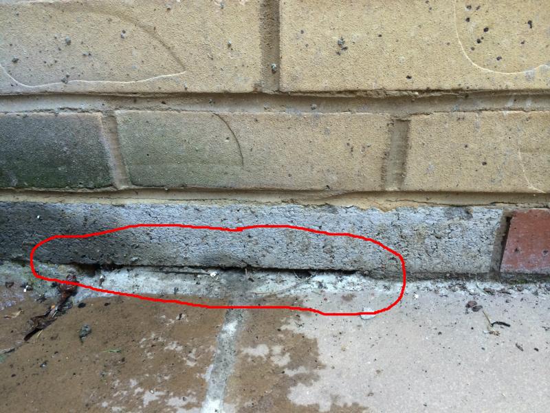

The holes I spotted are under that grey slab on the base of the extension (I've added another photo to make it clearer) but I realise those can't be sealed until I get the area dry.
You're right, the damp painted plaster in the dining room has lots of white powder coming off to I guess this could be salts and damp plaster. I'm not sure when to start hacking this off as I've been marking the dampness with a pencil line to see if it was growing and it's sort of useful to keep on an eye on it like this until the outside if sorted.

The holes below the concrete should lead to the cavity that i questioned you on? Maybe some moisture goes into the nearby solid house wall but i suspect that damp is penetrating from the too high yard corner.
Your kitchen slab shouldn't go under any cavity walls, it should cover the floor area only.

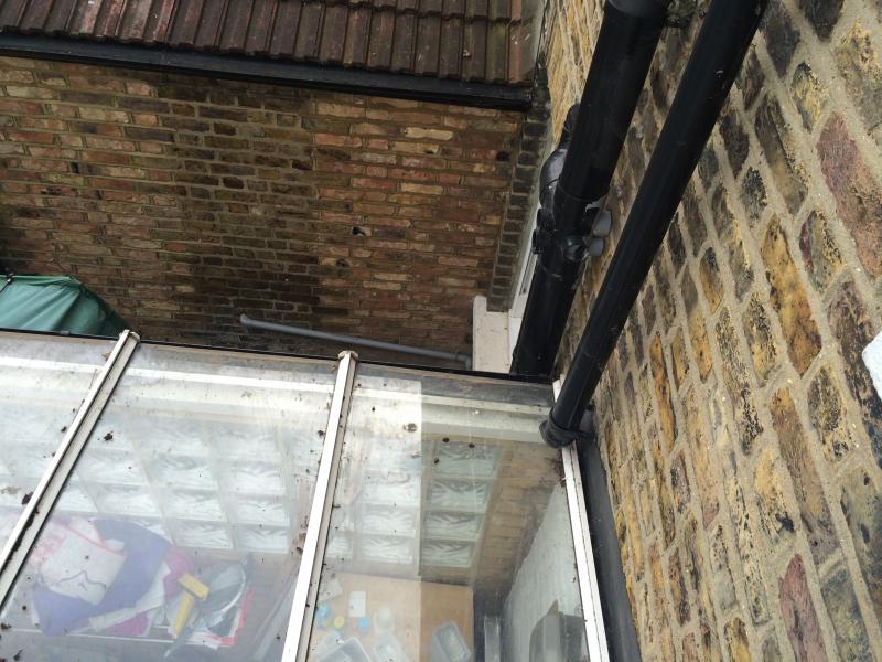

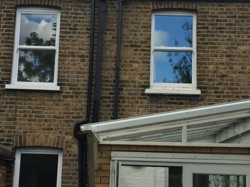

The RWP above your conservatory (?) should be extended to discharge into the conservatory gutter - simply lead the pipe end into the gutter, pointing the shoe down and along the gutter not across it. No kickout should then be necessary.
Where does this gutter discharge to?
Was your conservatory built by some company that advertises in the media? It encroaches onto your neighbour's property.
Thanks again, ree. The holes under the concrete slab can't be inspected further as it's a solid floor with terracotta tiles in the extension. I guess I just need to get the exterior area around it dry and get the holes filled.

I'll get an extension for the downpipe so it leads straight into the gutter - good advice. The gutter goes to a waterbutt in the garden. The waterbutt is full but the pipe leading to it is not as the waterbutt just overflows when it gets too full.
I agree, the angle I took the photo of the back of the houses, to show the conservatory, does look like it hangs over into the next door neighbour's garden but, thankfully, it doesn't. The edge of the gutter is on the boundary line.
