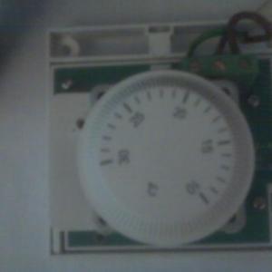

    Dear London Boy, I think you are right, the green/yellow is not as it seems, it is old wiring, certainly 10 years old, the boiler was replaced 4 years ago, but none of the ancillary electrics, stat, etc. Any help would be gratefully received.

    Hi, thanks for the reply, taken a photo, which I have uploaded into an album, but not sure what to do with it so you can see it. I have only taken 1 of the room stat, as I did not touch the junction box. There are 3 terminals, I have put the brown live to the far right, viewed from the front...

  4. Room Thermostat
    Room Thermostat
    Photo of room stat wiring

    Hi, I have just replaced the room thermostat on my oil fired boiler, with an RS1. It has 2 live wire connections and an earth, I had to get this type as I have a standard 3 core flex to the stat. I believe I have wired it correctly, however it has blown the 13amp fuse in the main boiler supply...
