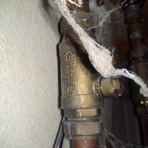

    Am I likely to break anything by turning either of the nuts while the water feed is still on?
  3. M
    Quick identification question for an expert please
    Thanks guys, I will try and see if I can get any further markings off them and hoover out the cobwebs first. I hope they are not flow restrictors as its only a gravity fed system so we certanily dont need any sort of restriction on the flow :)
  4. M
    Thanks Tony, just to clarrify when I say taps I do mean a mixer tap with shower head. I cant see any separate isolator valves installed however I have noticed that on all/most of the plumbing in this house (about 23 years old) my guess is either the builder didn't want to spend money on...
  5. M
    Hi there, Could someone please confirm what we are looking at here? There are two of these 'valves' connected on the way to our bath taps, my assumption is that they are double check valves, I am wondering if they are also isolator valves (which may make life easier replacing the taps) but...
