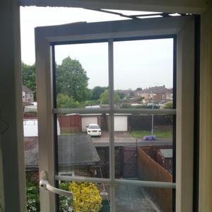

    Thank you for that. It's no longer under guarantee. It's not a gap between the glass and the frame of the window. But between the frame of the window, and the surrounding main frame. I've not explained that very well. I'm sorry. Hopefully these pictures will help. Hopefully you can see the gap...

  7. M
    Gap at top of upvc window
    The window is a side hinged upvc. When the window is closed, there is a gap at the top left corner. It's the corner from the top and the lock side (handle side) f the window. It's in the spare room, and I only really just noticed it. The window doesn't have a riser in the window. Could it have...
