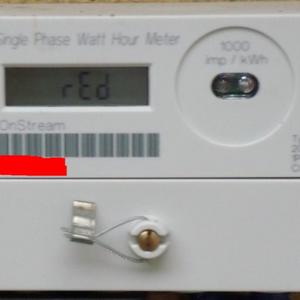

    landis+gyr 5235a red display
    I had hoped they (electricity company) would have changed the meter for a "Smart" meter but I understand they (meter company) havn't made enough to satisfy demand so perhaps they (electricity company) are waiting on that before they change it.
  4. M
    You have cracked it. We have just had Solar Photovoltaic Panels fitted and this would cause the reverse current. So the situation is normal. I wondered if a fault had been detected not having had any information from the installation company that this could result. thanks for the research.
  5. M
    Sorry for the blurred image but it was cold outside. The display looks like "rEd"

  8. M
    I have a Landis+Gyr 5235a electricity meter in the suppliers box which is showing a display of "red" or at least a display from numeric digital display which looks like "red". This alternates with the normal consumption meter reading. What does this mean?
