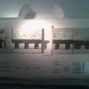

    This is a link to item http://www.qvsdirect.com/Excel-10-Way-Split-Load-Insulated-Consumer-Unit-C-w-Mainswitch-80A-30mA-RCD-6-MCBs-pr-22630.html All the cables are in the wall
  7. M
    consumer unit RCD
    From left to right RCCB 80A,shower,cooker,sockets,lights,boiler,main switch

    Just had a new consumer unit fitted it has 5 MCB and 1 RCD the electrician said it is 17th edition but someone has told me it should have 2 RCDs and the MCB should be split between them who is right.
