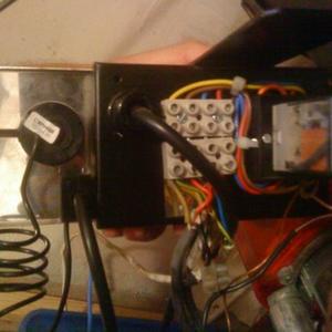

    Grandee combi Boiler not firing up
    Hi I have had a number of faults this year on my grandee boiler and the latest fault is no power to the motor that runs the burner. The amber light is on showing power to the control unit, but if i do a test on the female socket on the control unit, i dont get any signal to say that i have...
