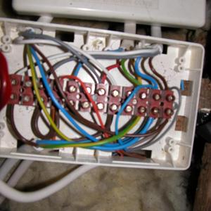

    Installing Honeywell DT92E into Danfoss WB12 wiring box
    A belated thank you to you both for the advice given here. Due to a string of bereavements in the family at the time of originally posting, I finally got around to fitting the thermostat a couple of weeks ago! The boiler, pump and CH actuator now shutdown as intended when the thermostat...
  2. M
    Hi there, Thanks for the speedy response. Hopefully this picture is sufficient: The cables on the lower side are (left-to-right) the pump, H/W valve and C/H valve. The middle cable on the top side is for the cylinder thermostat, but not sure which is boiler or programmer...
    Hi everyone, As per the subject line, I am looking to install a Honeywell DT92E wireless thermostat into my heating system's existing Danfoss WB12 wiring box to control our home's central heating. The system has never had a CH thermostat before, but there is a analog fitted one on the HW...
