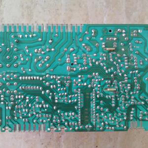

    Hotpoint Aquarius wm64
    Hi, thanks for replying. I took the on/off switch off because it was tripping the rcd everytime I went to switch the machine on, it does have continuity though, which is strange. The pcb looks fine, no burnt tracks as you can see. I'm at a loss, any ideas?
