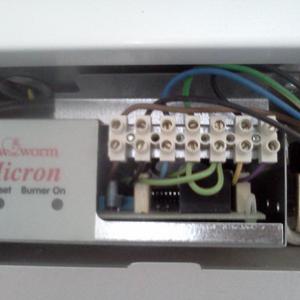

    Do I need a gas fitter to change a PCB
    A number of regulars in this forum have been very kind with their time helping in another thread here (http://www.diynot.com/forums/viewtopic.php?t=274445&start=0). This is looking as if the PCB on a Glowworm Micron 60FF may need replacing. I am an electronics tech, who is very used to...

    I did these measurements 2 or 3 posts back... This is with both stats down, and neither HW nor CH calling from the programmer... SL to Neutral on the boiler = 47v I removed the feed to the switched live at the boiler, and the end of the wire was 0v, and the switched live connector now...

    Yes Yes I am seeing the following voltages, but am convinced that when connected up, the boiler switched live is giving some strange results. No Call from programmer, room stat turned down cyl stat turned down C= 240, T1 = 47, T2=240 cyl stat turned up C= 47, T1 = 47, T2=240...

    Finally got around to checking the boiler voltages. First of all, just to mention that I changed the cable from the cyl stat to the airing cupboard connector block (brand new 4 core with the earth clipped back at each end), and the fault is still there. I am seeing 30v-80v (cyl stats down -...
