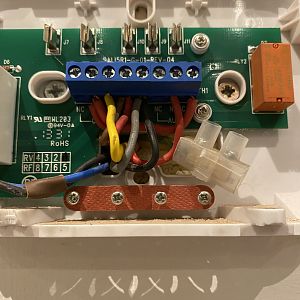

    IMG_0079 by MatCapri posted 11 May 2020 at 11:02 PMIMG_0076 by MatCapri posted 11 May 2020 at 11:02 PM

    If it helps at all, this is the layout of the control unit's connections - the labels are obscured by the cables on the actual device so thought this might be useful. Cheers.

    Thanks both, I thought I'd attached them, appreciate your input.

    Hello, my Salus wi-fi Gateway has finally died and it's time to replace the unreliable system with a Nest. Could anyone advise on wiring the Nest heatlink to replace the iT500 RX receiver unit please? The current wiring is as per the images attached, as follows: 1. Red cable from CH COM to CH...
