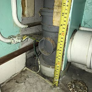

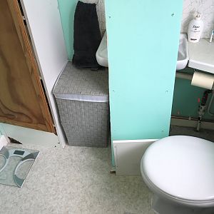

    Hey Guys! First post so please go gentle. I have recently moved into a property needing some medium/heavy cosmetic work and I am a very keen DIY'er, will get my hands dirty on any job. I just need a little guidance. I want to add a shower to the ground floor WC. I am fairly comfortable with...
  7. WC Left Side Wall
    WC Left Side Wall
    1: Gas Pipe 2: Mains Water Supply 3: Soil Stack
  8. WC Soil Stack
    WC Soil Stack
    Connector sat at 15cm in height.

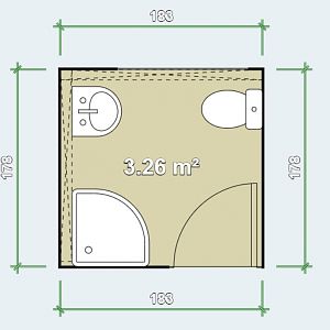

  9. WC_Layout
    WC_Layout
    This is the layout i want. The shower is small (700x700) but only used as a secondary.
