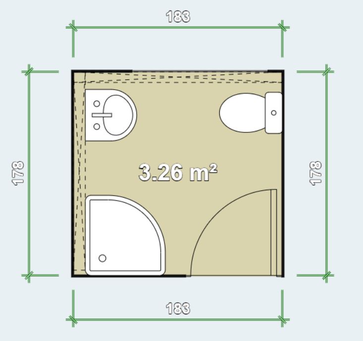

This is the layout I want to achieve:
The shower is only going to be a 700x700 but i need to run the waste to the soil stack which is only 1.8m away..... but how do i connect it.

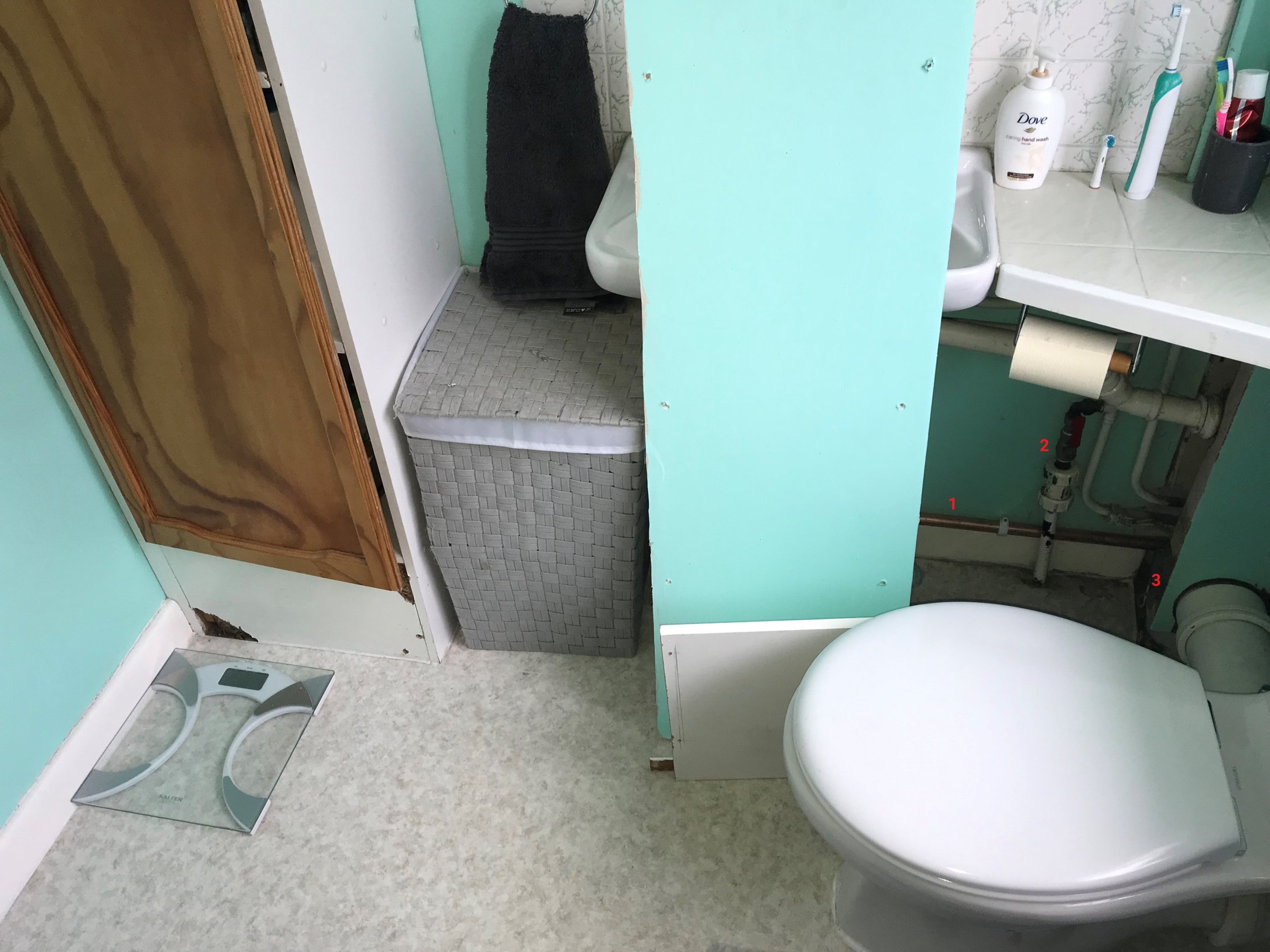

This is the side wall where the waste would most likely run:
Here you see, 1 is a mains gas pipe, 2, is the mains water supply, and 3 is the soil stack.

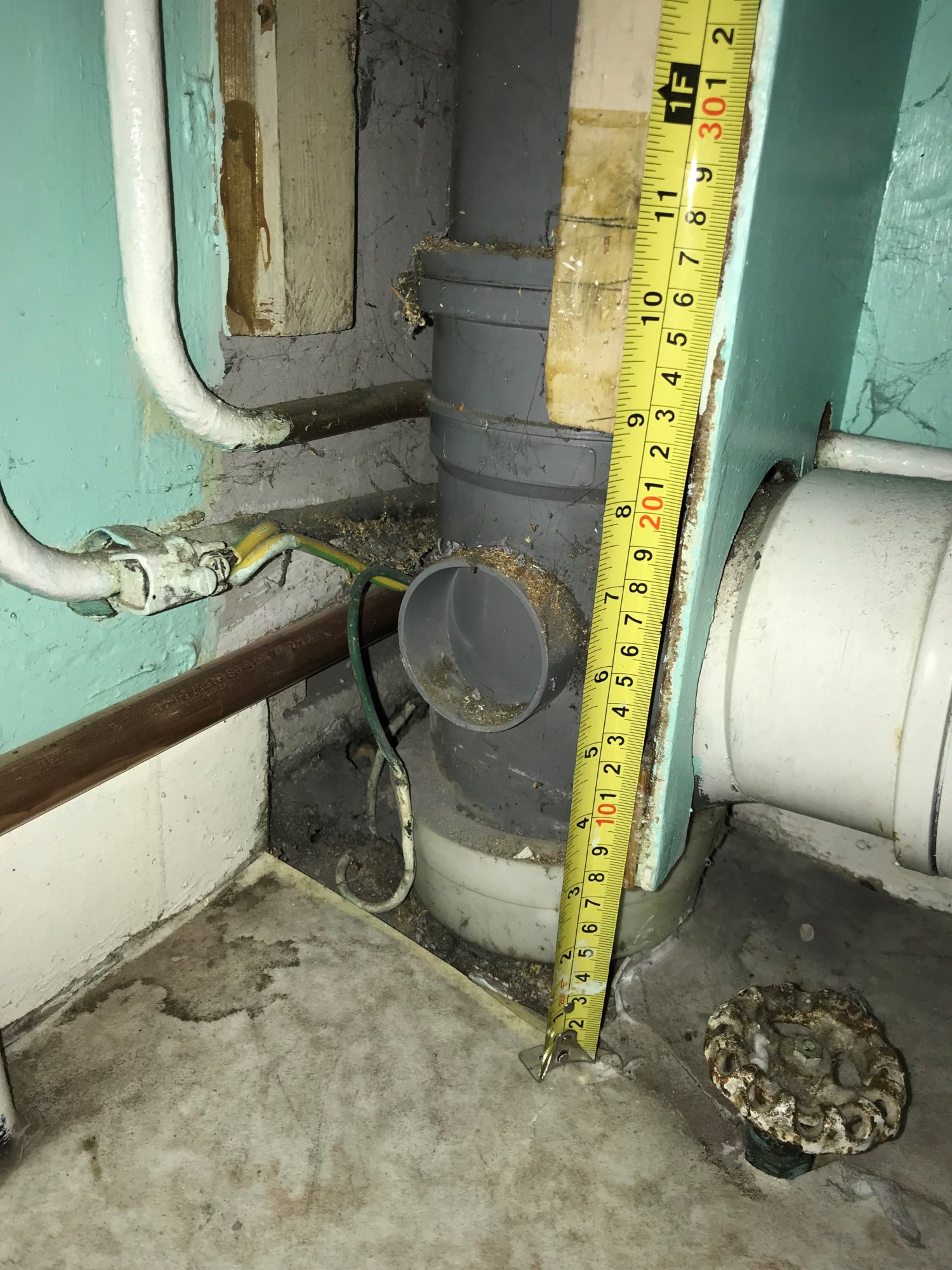

Sounds straightforward but the connector on the soil stack sits way too high:
I dont really want to sit the shower off the floor by 20-30cm, how do i get that waste pipe to run nicely???

That is no different to what I have already but the boss connector sits too high - unless you mean dig up floor and connect it below ground?
It's completely different. What I mean is where the multi kwik is (the white connection) replace with this and you should get your height.
What is the gate valve in the floor connected to? The McAlpine connector would do the job, but you may have to cut the stack above the branch, and rejoin with a slip connector to graft that connector in. Not ideal, but infinitely better than digging the floor up.
Pretty sure thats the rad drain off valve - its no longer operable since i had the CH system redone.
