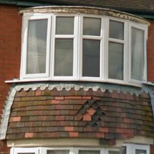

    Bay window cladding
    Thanks Pinnacle69! I had seen people talking about eurocell, and found there was a branch near me. They also advised the shiplap which I ordered. A friend runs a scaffolding firm so is putting something up for me to do the work. Certainly sounds like good advice doing it over two day! Fingers...
  5. M
    Bay window cladding
    Hi all, Please see below photo of my tired looking bay window. I have seen some people in the area have replaced the tiles with UPVC cladding. I had a look on the forum and found someone who had done something similar but their bay was square. My question really is can I just peel back...
