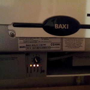

    Baxi Solo 3 50 PF intermittent burner.
    Thanks all for the replys. I'm sure the thermistor is ok, the contacts are clean and the connectors tight and it measures ok. so possibly gas valve solenoid. I've read on other posts about a faulty APS causing similar symptoms. Is this a common fault. I'm an electronics tech by trade...
  2. M
    I have a problem with my Baxi solo 3 50 PF. In the initial instance when the CH or HW demands heat the boiler on indicator will come on, followed by fan indicator, fan starts, then pilot ignites, pilot indicator on followed by burner and burner indicator. It will run like this for 5-10...

  5. boiler
    boiler
    Baxi solo 3 50 PF
