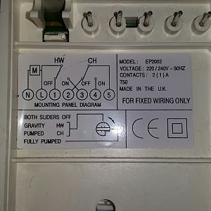

    Called nest installer.... Everything was wired up correctly... But.... when i added nest thermostat I just taped up old wires and held in place behind wall. They needed to be joined then hidden. They gave power to somewhere else. ANSWER : Join existing thermostat in living room wires...

    Just connected nest 4 to potterton 1 (NEST EMAILED ME THIS, TOO) No change...HW works Heating does not Added nest 1 TO potterton 2 and this also is the same result. (Also like nest said) The links they said usually not needed have been added...no change???

    The timer front i have taken off. But backplate i have left. The nest controls the timings now. All original wiring is as the photo

    Wired up a v2 nest before, no probs. Version 3 has hot water also. I have a Nest V3 Programmer was: - Potterton EP2002 (2 channel - Hot water and Heating) 1 x 3 port valve 1 x Hot water tank - Not plugged in, as gas heats all water. (never been plugged in) I have the following connections from...
