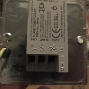

    It was given to me from a woker there who advised that one, but I have never heard of a slave unit. Never had 2 switches in my room. Now i no, the dimmers will be taken back and changed. I will then fit the new ones.

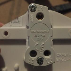

    Fitting dimmer but not working
    Dont know if you can see these pics, first time uploding on this site. Theres an album anyway. the broken switch is the old one, the other is the new dimmer. I have 2 of these and both dont work. someone please describe how these are wired to confirm what im thinking.[/img]

    http://www.varilight.co.uk/leaflets/intelligent651.pdf Same as Page i have.[/url]

    I Live in a Flat if that makes any difference to the wiring, im not sure but may help for information.

    Hi, I hae fitted many switches in the past but this switch is testing my patience. im sure the switch is dead. Got 2 switches from b and q today, 1 for the bedroom and 1 for the front room. bedroom has 2 brown connected together (C L1) and 1 brown on its own (L2). Also has a earth connected...
