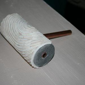

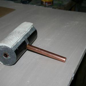

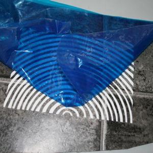

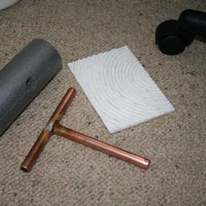

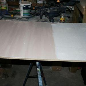

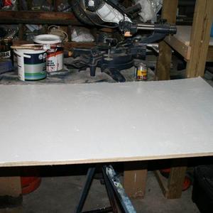

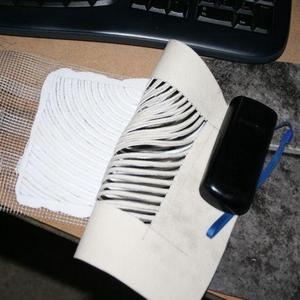

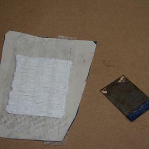

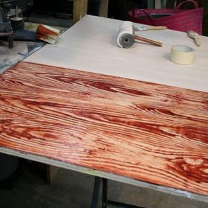

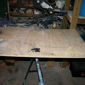

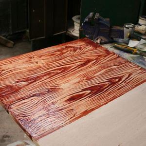

    faux wood grain
    Hi there, I want to show you my DIY- have done this for first time so pls be tolerant in your comments first of all- if you want to paint faux wood grains- the easiest way is to buy a suitable tool, read some instruction and go ahead... I don't like to go for simplicity so have made graining...
