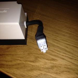

    HPA 2 Danfoss Actuator Issues!
    Hi Ian This is the type of connector on the current HPA2 (piece of s*** that it is) and i'd like a replacement Actuator that's just as easy to fit if possible. Obviously of better quality!
    Are there any Actuators out there which I can simply just fit and click so to speak. Replace actuator, fit retaining screws, and plug into the terminal, just like the HPA2 has now, instaed of wiring into the wiring centre? thanks again folks
