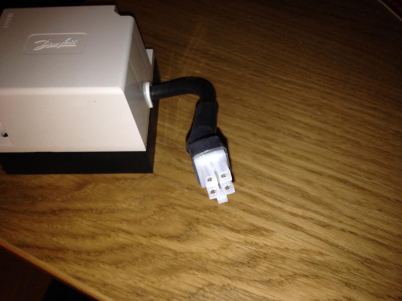

Hi All
After posting my problems last week, I think it boils down to this little tinker as the source of my problem - the Danfoss HPA2 Actuator.
Can anyone recommend a suitable replacement actuator for me, if possible with the easy fit square plug option?
Myson power extra or personally I'd remove & fit Honeywell's

Are there any Actuators out there which I can simply just fit and click so to speak. Replace actuator, fit retaining screws, and plug into the terminal, just like the HPA2 has now, instaed of wiring into the wiring centre?

The HPA2 doesnt come with a plug in connector as you describe , it sounds as though whoever changed it last has used an inline connector, BG and SSE carry these as van stock and I think one of these has been used, all you would have to do is split the connector and rewire your new actuator in the same configuration then plug back in, if you post a pic of the connector I will be able to confirm if this is what you have
That is a new one on me mate I have never seen a connector like that on a Danfoss HPA2 I did hear that they were considering doing that about 2 years ago but have never seen that, why not contact danfoss direct ?

You've got a pre-piped Range cylinder. It looks as though Range have put a nice little connector onto a standard Danfoss actuator to force you to pay an extortionate price for another head. Great little scam...they fit rubbish zone valves and screw you over each time they fail. These pre-pipe cylinder manufacturers often like to use ball valves on the pumps too...another way to boost income too when they leak.
As previously mentioned best long term option is the replace both zone valves with Honeywell.
Otherwise just get another Danfoss actuator and wire it directly into the wiring centre on the cylinder dispensing with the connector.
