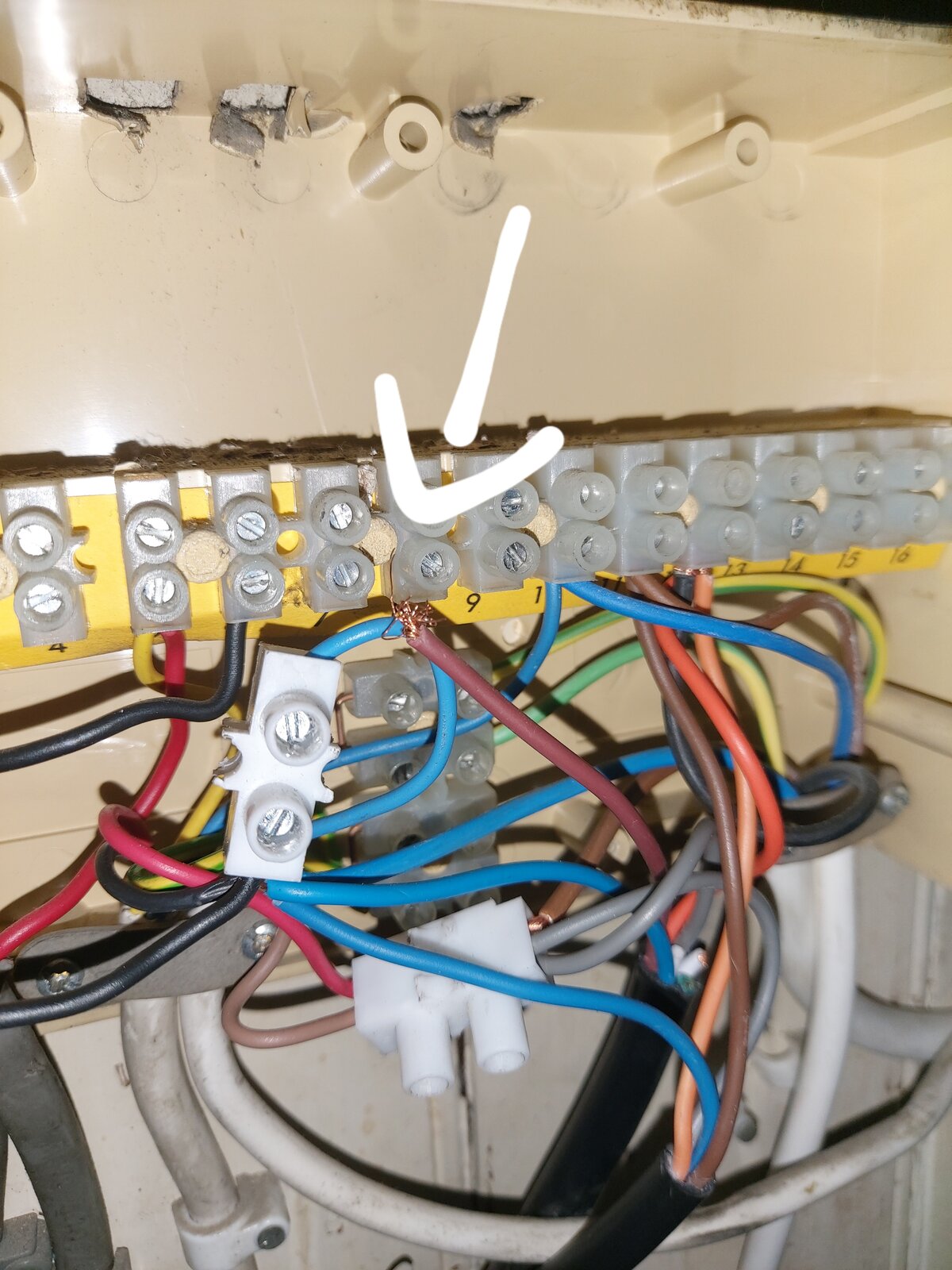

Sooo... Looks like a school boy error but the brown wire from the Drayton isn't connected! How on earth did i miss that!
Now the question is where do i connect it too. Obviously after I switch the mains elecy off.
I'm really racking my brain here. Clearly my wiring and observation skills are some what to be desired! But atleast, with thanks to your help, we may have found the culprit!

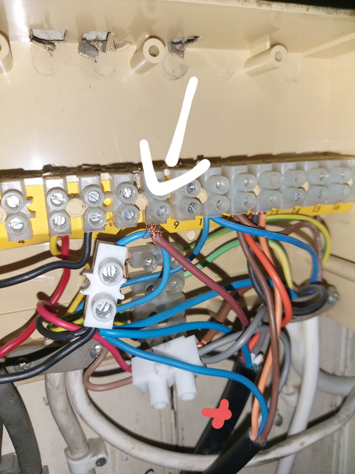

I took pics before i started fiddling around - lo and behold I can't see the journey of the brown wire from the drayton! How?? Clearly my photography is somewhat to be desired too!
The red 'X' is the Drayton wire and the white arrow points to the the non-connected brown wire in question. The black wire next to it, which is out of focus, leads to the Danfoss

The brown wire from the central heating motorised valve should be connected to the switched live wire from the room thermostat. Unfortunately there are no standard colours for the wire or which terminal it's connected to. Those choices are down to the personal preferences of the original installer.
It can be traced physically from the thermostat, or with a multimeter. The required terminal will be 'live' when the heating should be 'on' and not 'live' when the room thermostat is turned down, or CH at the programmer turned off. That's the terminal where the brown wire should go.

I fiddled around and wasn't sure which terminal the brown wire should go. The boiler is upstairs with programmer / thermostat downstairs. Wasn't confident tracing wires and I don't own a multimeter.
I kept looking back at the pics i took before I 'rewired' the danfoss and couldn't work out the journey of the BW. Just my luck.
Long story short called out a sparky that was recommended by a friend - took him no time to work it out, traced the brown wire to the live and voila. So far so good, the CH is coming on independently on all functions.
Will keep my eye on it. Fingers crossed that should be it.
Thank you for you're time and advice Stem. :) very appreciated
