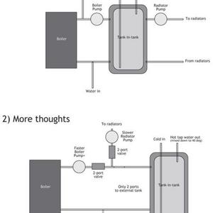

    It might be barmy - I think Simon's point regarding the boilers is critical. I'm using 2 Amptec boilers which need a high flow of water across them to prevent there being no more than 14 deg C (from memory - may be wrong) rise in temp across the boilers. I suspect that this is where I open...
  7. M
    Tank in tank thermal store with 2 primary connections -issue
    Simon - thanks for that. I came up with something quite similar I think a few days ago - I've uploaded a schematic which explains it I think. But basically 2 pumps and two 2 port valves: One pump + valve for the rads, another pump running faster than rad pump and pulling from boiler again...

    I'm trying to avoid using just the boiler to drive the CH direct - I want to use some of the energy in the cylinder but maybe I'm making life too hard. From my understanding of the installation diagram that isn't possible. Reason is that I am (for now) stuck with elec boilers and cheap rate...
  10. M
    Hi I bought an ACV SLE 240 tank believing from their website that it would have multiple connections (the plus model) and having found a cracking deal. Well, as ever if it's cheap there is a reason: these were clearance units and were not the plus version (and are no longer sold) - only coming...
