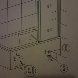

    Choice of bath screen/sealing screen to bath
    eta: see point 2 on this instruction step That's what you get when you buy off e-bay :? [/img] Oh well, it's more advice than what exists for the backlit mirror.... will post another topic for that!

  9. M
    Had an interesting discussion with the fitter this morning and established what his concerns over this problem actually are. Where the two glass panels meet and hinge the bottom of this hinge is simply fixed to the bath with a small screw. The screw purchases into the wood baton running...
  10. M
    Like that but without the bracket at the top going into the wall. Sorry I can't find the original e-bay picture (that's where I bought it from)[/img]
  11. M
    Bathroom project coming along nicely, I've managed the project but have got a bathroom fitter in to do the actual work. The bath is fitted and surrounding area is tiled. There is a wall running along the long side of the bath and a 730 mm wall against the end so the bath has tiled walls on two...
