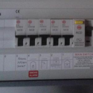

    New single RCD consumer unit
    The fridge sits on the second kitchen ring. It has run for days on an extension lead from living room sockets fine. I now want to make sure the labels on the front match whats in the CU. You know a sanity check. The tenants house is 80 miles away so I will need a to do list next time I...
    But knowing that it could be 1 or more toasters/kettles on a ring thats faulting is a huge help. Would a fridge on load (cooling) have the same electrical properties as at idle? I calculated that the shower pulls between 30-40 amps(max). Would a high current device leak more that an iron or...
    To follow up on this. I have spoken to the the electricians who installed the CU and asked why a single RCD installation was used. The reason was the existing wiring would need to have been re-wired to split the upstairs lighting/sockets from the down stairs lighting/sockets. This would have...
    Wow I dident realize it was that low. I really thought it took amps. So it would defeat the whole object of the rcd. I had the rcd put in because there were to youngish kids moving in. And young lads do like to play. So the 30ma one is staying Thanks for that
    I will confirm that with the tenant. I know it needs to be left off to get up and running again. Hence the thinking that the two are in someway connected. I have actually seen the switch off when I visited(often at the moment)
    Yes .... there are a number of inputs into this from different places. An electrician "up the road" from the tenant says the rcb is too sensitive. I should use a 100a 100ma. ?? is 30ma to 100ma really going to solve the problem?. But I agree that changing the rcd might just mask the...
    Now at this point I only have the tenants word. I know the RCD trips because all power goes. I believe when she tries to turn the switch back on it fails. She follows the instructions in the pamphlet for the CU and switches all the MCBs off. The switches them on one by one until one causes...
    It was the very first thing I checked. Resealed around bath. New shower unit installed by same electricians. They had the "tails" out of rcd and re-tested them (not sure what the test was). They reported the system stable. I have run the shower many times in one day - no trip. Had 2 of...
    The company who did the work was recommended by somebody who owns 20+ rental properties. I was satisfied by the work done. BUT there was no mention of a single or dual rcd. All other work done has so far worked fine. I assumed the certificate takes ages to drop thru the door. I will chase...
    Thanks for the info. I pretty much confirms my thoughts. A dual RCD box should have been put in first. When the existing single RCD box trips ALL circuits are dead. It also would help in the diagnostics to be able to split the loads. At the moment the rcd trips when the tenant is in the...
