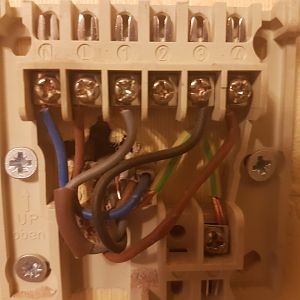

    Sorry been a frustrating day. This is what I have done so far. I know the wiring needs tidying up Remove wires from timer . Live goes to live neutral goes to neutral From live link to 2 and 5 Then from old timer put 4 of old timer into 3 of nest =ch on. Then 3 of old timer into 6 of nest...

    I have installed the nest replacing Grasslin control box and Honeywell thermostat. I can only get hot water and heating when the nest thermostat isn't connected. Any suggests??

    Thank you for your help!! Nest is working!!
