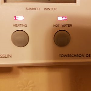

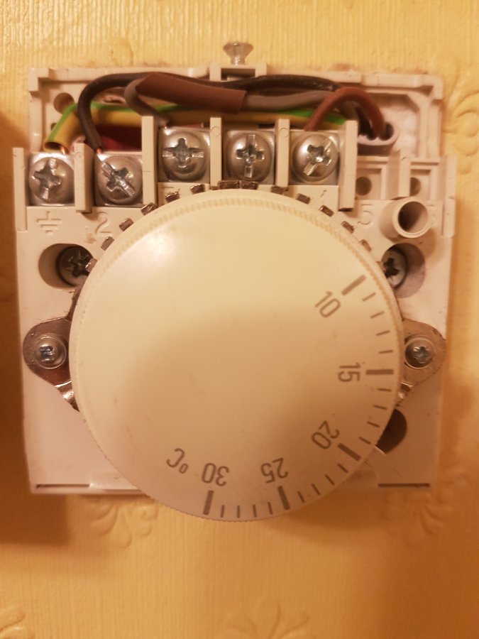

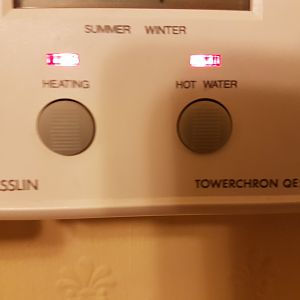

I have a grasslin tower chron QE2 and a mechanical Honeywell thermostat. Is it easy to fit the nest
Should be ok with a Nest but need a bit more info about the system.
Is there a 3 port valve ( looks likely from the wiring ) and do you have a room thermostat?

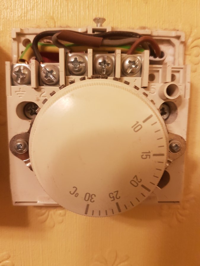

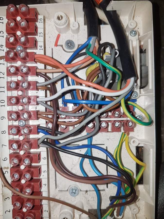

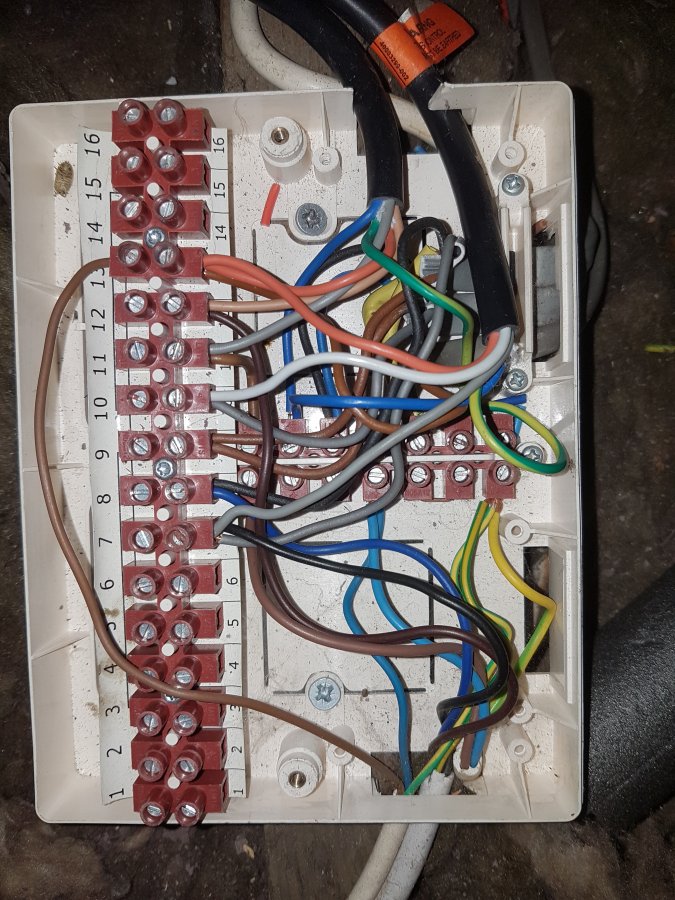

Some pictures of the room thermostat wiring and the internals of the main wiring centre would be useful.
Remove wires from timer .
Live goes to live neutral goes to neutral
From live link to 2 and 5
Then from old timer put 4 of old timer into 3 of nest =ch on.
Then 3 of old timer into 6 of nest =Dhw on
Then 1 of old timer to 4 of nest = Dhw off.
Remove wired room stat and connect common and sl together = 1 &3 .
Then you can have the nest as a wireless set up only .

The part I didn't understand was this

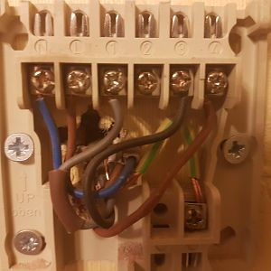

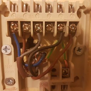

Also I was asked to include the wiring for the main box and the thermostat
Your help is appreciated

Disconnect the room stat, it looks like its the grey wire in pin 10 and one of the browns in pin 9
Move the white wire to the 3 port valve to pin 9
Room stat is then bypassed
You will also want to remove the neutral and earth going to the old room stat as well. Follow the brown and grey wires back and you'll be able to find which black and green/yellow one it is. Once finished tape it up or cut it off so it can't touch anything and become live.
You could use those wires to power the Nest stat if you're putting it in the same place as your wired stat, and you have two spare cores between the heat link and the wiring centre, I didn't, so I've just got my Nest stat plugged in.

I have posted some photos on line. I am going to fit it on Saturday
Thank you I am going to fit it on Saturday
I thought the working was working but it isn't unfortunately. I can only get heating and hot water when the nest isn't connected. Any suggestions???
