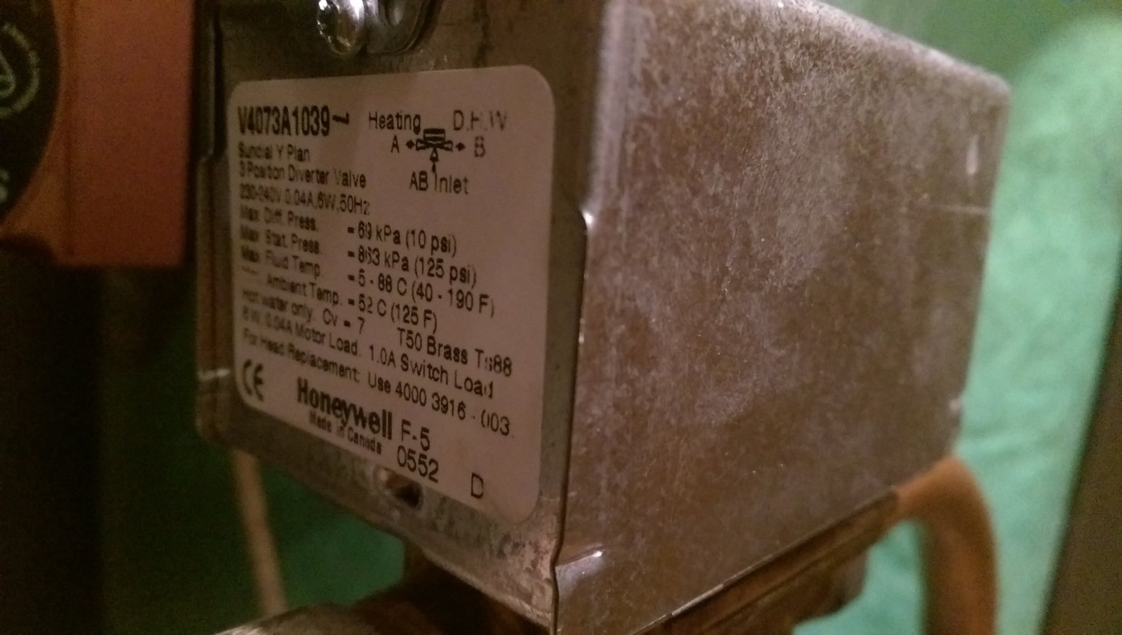

Y Plan config (Honeywell F-5 3 port valve) gravity fed

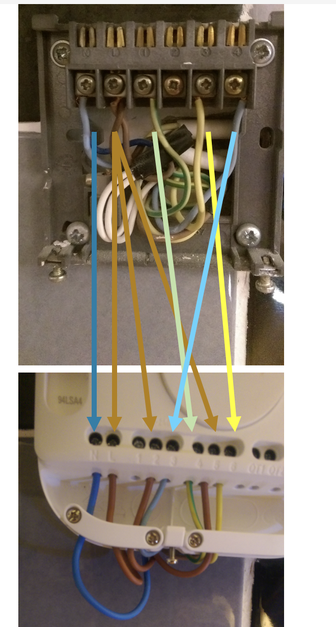

After reading https://www.diynot.com/diy/threads/nest-danfoss-compatible-how-to-install.493478/ and http://lifeofman.co.uk/2017/06/install-nest-learning-thermostat-3rd-gen-y-plan-system/ I followed the same wiring:

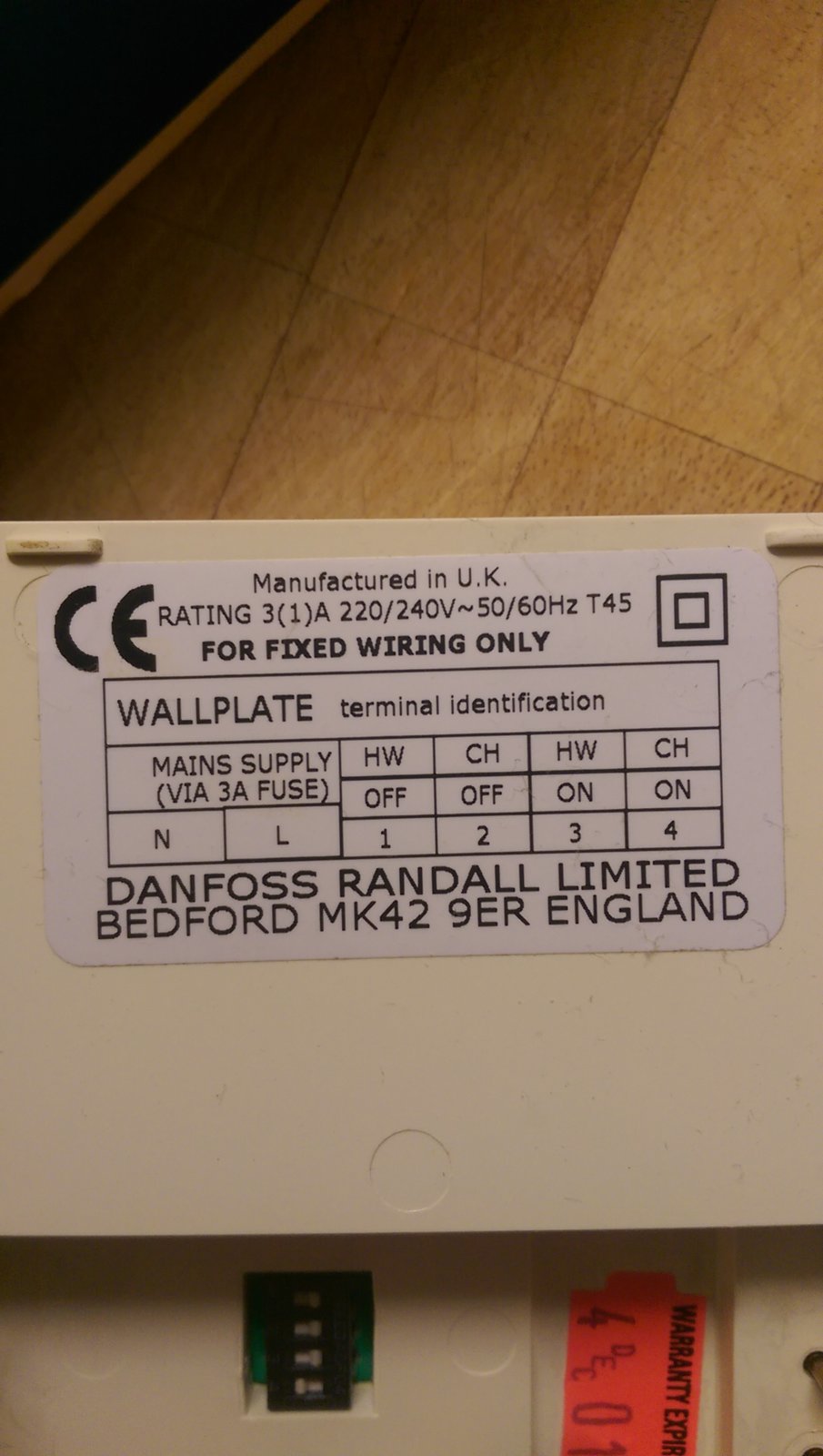

CP715 Nest Heat Link
N-Blue N
L-Brown L
1-HW Off Earth colour 4
2-CH Off None
3-HW On Yellow 6
4-CH On Light Blue 3

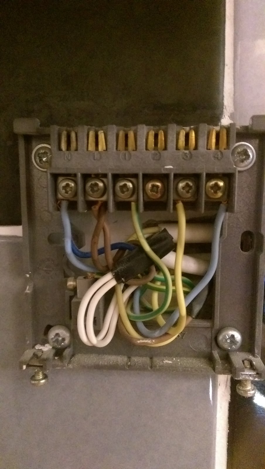

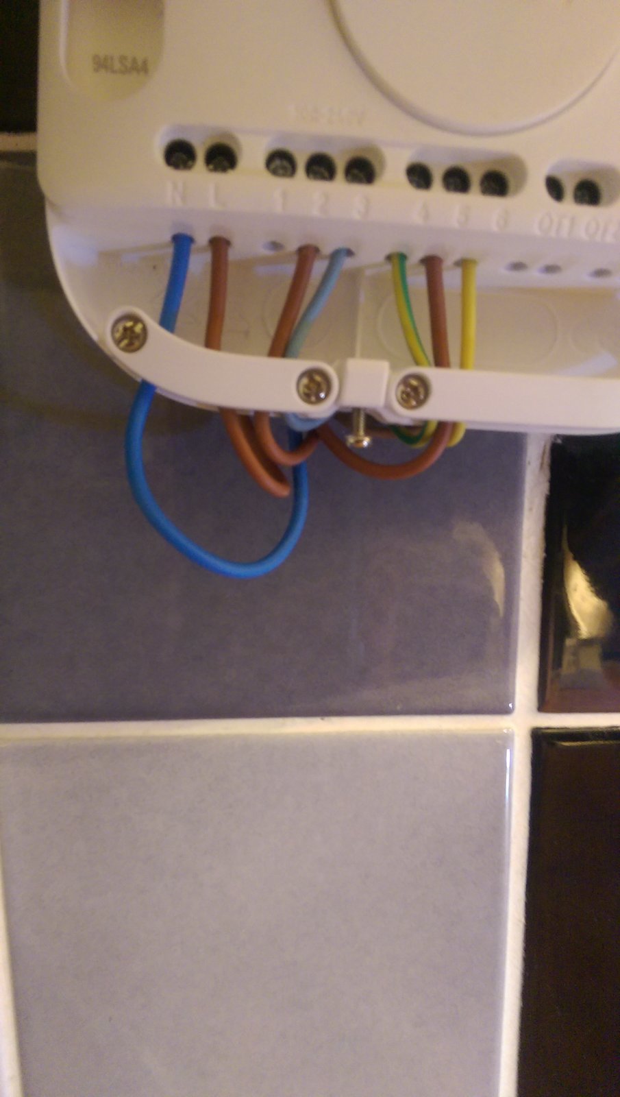

I also read about having to connect LIVE to connections 2 and 5 (common), which I have done induced by the pic with the arrows from the CP715 to heat Link. The backplate photo shows 2 live and 2 neutral wires - I've connected each via its own Splicing Connector. (handy! https://www.clasohlson.com/uk/Wago-221-Compact-Splicing-Connectors/36-6521)

Admittedly I didn't check the wiring of the Honeywell 3 port valve, but cant understand why Nest is not controlling the boiler.

The wiring looks exactly as it should as to where it goes. (there are one or two installation issues that won't effect operation though) Well done with the post showing both items and the arrows showing the changes, very helpful (y). Have you changed any other wiring anywhere? Was there an existing room thermostat for example?

I assume he installation issues you're referring to are the use of an earth colored wire for one of the controls?
Sort of:
1. The green yellow wire should at least have a brown sleeve on it to identify it is being used as a live wire.
2. The outer sheath of the cables should extend below and be secured by the cable clamps, not the wires themselves.
3. You haven't made a connection to the Heat Link earth terminal. But to be fair according to Nest, this is only necessary if you are using the T1 & T2 terminals for the thermostat, and I can't see if you have or not.

1. The earth cable - yes, i need to get some brown sheathing, the earth is courtesy of the last owners/installer, who didn't do a good job
2. Agree, I connected it all up temporarily, as, I want to use the 'holes', well, there seen to be 'outlined' parts of the back plate below the wire connections, suggesting they can be drilled out, so the wires can pass directly behind the Heat Link. The temp connections were also to test, and I'm glad I did!
3. I've got the earths which were terminated on the Danfoss back place tucked away, so I could connect easily. Not using any other thermostat; the hot water tank thermostat connects into the control box next to the tank, but to be honest I don't think it does anything.....

With the three port valve, [I know a Honeywell V4073, not familiar with F5 though] The Heat Link terminal 3 (heating call for heat) should connect to the motorised valve's white wire, so that when the heating comes 'on' it winds the valve from rest, to one of the two heating positions. If only heating is required, the valve is fully wound across to the 'heating only' position and a microswitch inside the valve operates and makes the motorised valve's orange wire live, this is what controls the boiler.
When the hot water is running, the boiler is controlled by the hot water cylinder thermostat instead and not the motorised valve.
The cylinder thermostat gets its power from Heat Link 6 (hot water call for heat) and the cylinder thermostat switches the boiler on. If the central heating isn't calling for heat, a spring pulls the valve back to the hot water only position.

I was about to work through your wiring, and I worked out the 3 port valve is a V4073A (not F-5) so I also had that diagram ready, then contacted the Nest support via chat.
