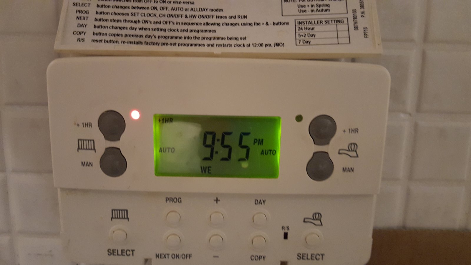

Hi all,
Complete newbie here - I have never touched anything close to plumbing/electricals, so please arm yourselves with a lot of patience.
We live in a rented house and would like to install a Nest to replace the current setup.
The reason I would like to do this myself instead of calling a professional is because I want to be able to 'undo' all of the work when/if we decide to move to another place.
Can you please help with:
a) identifying if Nest will work with our setup? (their compatibility checker said 'no' straight away, but I am hoping that's not true)
b) how would we wire the cables in picture 3 to the Nest?
c) can we leave alone the British Gas thermostat or do we need to mess about with it?
Many thanks!
This is the control panel that 'lives' right underneath the main boiler.
The panel's back:
The wires:
This is the boiler:
A couple of metres away (in the next room) there is also one of these, that we have never used:
