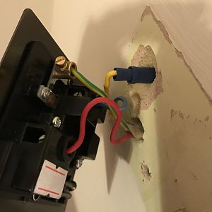

    This is the cabling I am staring at now, just trying to wire up. http://www.diynot.com/diy/attachments/image-jpg.110634/?temp_hash=ed4f3bb384608951b9f3b2824dd919c5

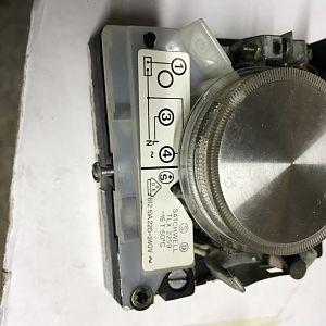

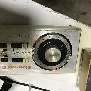

    Yes I wired in a socket to keep the wife happy and the danger out the way. I did think that about the earth but the Instructions don't really mention it for this set up. No i had 1 as Red and 3 as Yellow on the old thermostat.

    The cabling from the thermostat will this be the four core cabling? So I remove the L (Red), N(Blue) coming from the thermostat from the terminal connectors therefore disconnectin it behind what would I use for call for heat on the heatlink with the yellow cable (brown in 3 on the heatlink...

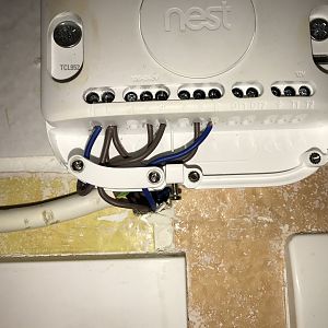

    Yes thats right, I believe they are coming back to wiring box behind the heatlink. If so this is how they are currently wired in. Red to a live terminal connector with the mains live and a cable to L on the heatlink, Blue to a terminal connector with the mains neutural and a cable to N on the...

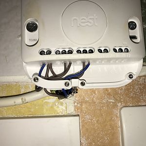

    Hi, Thanks for the reply. Pictures now attached. I believe the old thermostat cabling comesback into the heatlink but it is wired to the mains behind the heatlink. Could it be the case that I remove it from the mains and put in t1? The yellow cable I use in the call for mains in 3 on the...

    Hi All, I have recently purchased the 3rd Generation Nest Thermostat. I managed to wire the heatlink up replacing the old controller next to the boiler. The thermostat connects perfectly and this now runs smoothly and I can trigger the heating on and off wirelessly. My next task was to...
