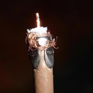

    Connectors for aerial coax cables
    I'm good at confusing people :) The only electricity in the loft is the light circuit. I'd managed to run a long extension lead from the floor below into the loft, and plugged the remote power supply for the amp into that. I then attached an ordinary co-ax lead (usual Male to Male one used...
    Thanks for the input, but I'm still having a bit of a nightmare with this. In the end, after much f*rting around, and refitting of connectors, I managed to get a decent connection from the aerial to one of the upstairs rooms...great digital picture (awful analogue, but I dont really care...

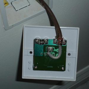

    I've had a look at the back of one of the co-ax points in the room, and it looks fine...in fact looks quite a nice job to me...copper central wire is still fully insulated, and outer thread is completely separate... So I had a look at the loft connection: Should I strip this...
