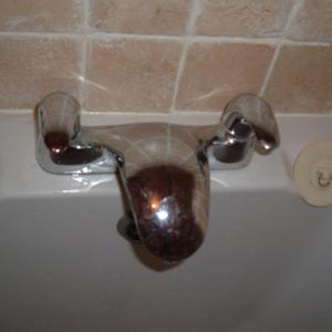

    tap

    hot tap problem
    The boiler is firing up but the water is nowhere near as hot as the water from the other hot taps. Is there any way I can tell if it is a thermostatic mixer tap?
  12. N
    hot tap problem
    Running of combi boiler. Not sure what tap type is - hot and cold taps running into a mixer.
  13. N
    hot tap problem
    I moved into my flat in June and have had no problems with the plumbing until now. All my hot taps are working fine except the bath mixer which is only producing tepid water. Most frustrating as now the cold weather has set in it is not I want hot bath water the most. Can anyone help me...
