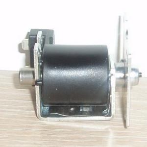

    Ideal Classic - replace pilot solenoid
    Hi - wondered if anyone can help with a simple problem. I need to replace the pilot solenoid on the gas valve on an Ideal Classic LXFF 260. The gas valve is a Honeywell VR4601A/A1036. I have taken the pilot solenoid off but how do I release it from the silver clip (see photo). When...
